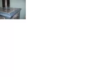

stove up to 350 right now and it smells like burning plastic.
One other thing I did notice is, from the outside lleft upper seam, where it is leaking in the picture.
YOu can see that rope stuff, that is used to seal around the doors.
Do they use this to seal the box?

I took a second look at the photo (enhanced and enlarged here). That does seem like a fair amount of smoke coming out of the upper right top of the stove. It may be that you need another 2' section of pipe on the flue and perhaps a cap that deals with strong wind. How strong are the gusts you are getting now and what temp is it outside?

Do you live near Peoria? I'm thinking it is just too warm and windy to get good draft without more pipe.
