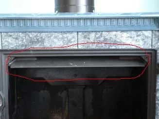

here is a picture of the space I'm talking about, I circled it . Is this suppose to be an open airway?
That space is for the air wash. Air runs from the primary air contol lever beneath the stove, up the side castings on either side of the front door, and then pours out through that space. Primary air also squirts out through the little hole in the doghouse. I don't see any cement. The key thing is that the air feeding that space comes from the sides.
The air wash on my stove works great.
