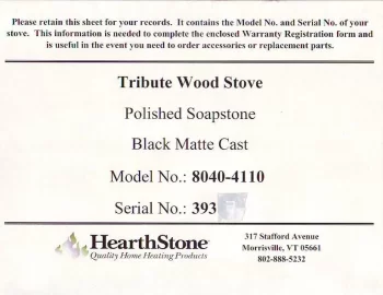

does anyone know if there is a serial number stamped on the stove, other than the tag in the back?
I seen some numbers stamped on the inside, opposit of the side door.
I recall there being a certificate that was in an envelope with the owner's manual (a must read), may have had serial number on it. Not positive though. How tall is your venting system overall?

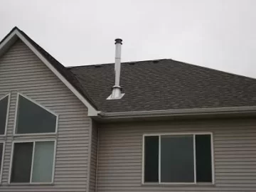

Holy moly. I'm not one to condemn a fellow brick and mortar retailer but from stove to chimney cap you got hosed. Like someone else suggested in another thread, Video the stove in action and Youtube it. The dealer should be ashamed, the chimney redone with proper height and bracing, and attic insulation shield and god(sorry muslims) knows what else they missed. Also, I would demand a new stove NOW before the shop gets any busier. That is a disgrace to our industry

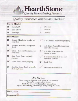

Okay I scanned the certificate and the Hearthstone Quality Assurance Inspection Checklist. There was also the owner's manual and warranty registration but I didn't scan those. My stove was made in early 2006.

Funny to read the checklist.
Things like bolts to pallet, cracks, leak test, etc. that are exactly what this thread is all about.

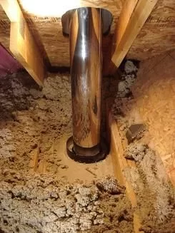

They must have used a roof support. But they still should have framed the opening. And by now I'm sure you realize your missing the attic insulation shield, which, according to selkirk, is extremely important.
Did you already post pics of the interior of the ceiling?

They took some pictures of the stove with thier phone. I told them that the chimney might be to short, that should be 8and a half feet tall(104'')
They said it should be tall enough. They said it is over ten feet away from the roof , and it should be good. they said it is 5ft tall. I also asked why the chimney stove pipe going through the chimney is not framed out in the attic. They said only the square mount gets framed out not the round one.
I also asked why the roof flashing was not flashed. They told me it was under the shingles, they said the top half of the flashing is about 10 inches longer, so ten inches of flashing is actually under the shingles. I will get up on the roof this weekend and check. As for the attic, well thats just crazy.
I called the dealer while the installer were still at the house. I asked the dealer about the frameing in the attic, and a heat shield, and a insulation shield. He said he would look into it. I let him know I would be calling the inspectors out to look at it.

something has to be framed either the ceiling support or a roof support. Of course I just going be the directions on the selkirk website. Maybe there's another way, but that doesn't seem right. I would still get an inspector even if it was the fire dept. I'm sure they will come out for short change. probably even for free.
