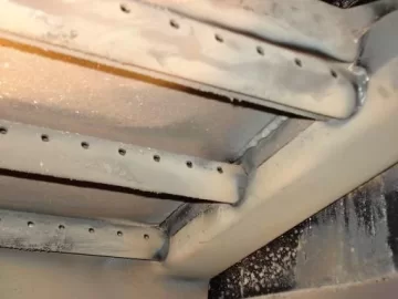

Here is a picture of the inside of the stove.

How about another photo right down the middle. The cotter pins should run through the center tube nearer the center and the front tube has a pin right in the middle holding that bracket in place. I see that cement you spoke of beside the baffle.
You sure are burning cleanly. The cast iron secondary manifold on mine always has a black or dark brown color to it.
