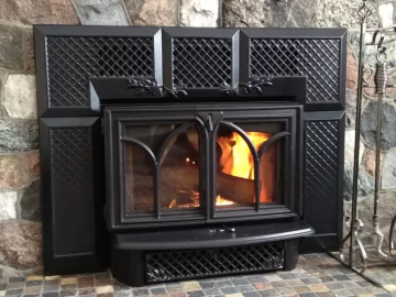

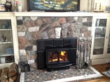

So as I posted a bit earlier on, my C450 was installed last week by a local shop. They came today to do a few tweaks (levelling the unit, sealing the chimney, install trim kit).
The trim kit they brought was the wrong one, its the 'Tamarack' pattern, instead of the Kennebec. I hadn't liked the look of the Tamarack in the glossys at the store and online, but now I'm undecided. I can probably get a break on price if I decide to keep the Tamarack.
Attached are pics of the Tamarack installed (at my house), and a stock photo of the Kennebec. The Tamarack has a more 'busy' pattern but goes with the pattern on the leaded glass of my side cabinets. Conversely, the Kennebec is more in keeping with the style of the stove doors, and a cleaner look.
Just wondering what others opinions are on this (ultimately I have to decide, but looking for input).

In my opinion the Tamarack carries the flow of the pattern on the fan input around the stove. The smaller pattern not only complements the doors on the side cabinets but also acts as a transition to the small tiles on the hearth.
If you would like the opposite opinion I will ask my wife to post her's...
[Hearth.com] Opinion - Jotul C450 Kennebec or Tamarack surround?
Personally, I would go with the Tamarack.

I am starting to warm up to this particular look. I will have to check with my better half and see where we stand :)
I agree it transitions nicely...

Does the Tamarack surround vent the fireplace cavity? If yes, I would consider that a plus.
Oddly enough, it comes with a plate to block off that opening.
In my case, with the uneven rock fireplace, there is plenty of gap to vent anyway :)

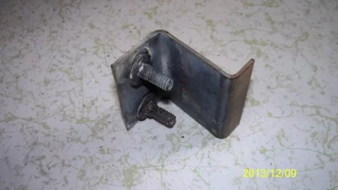

TheBaron - thanks for the reply. I did one other crazy thing recently and it really helped to keep my windows clean when I draft down all the way. I welded two short stove bolts to a small piece of thick metal and formed a lip for a handle (see attached pic). The stove bolts were welded with their heads to the metal and spaced exactly the space between the two air jets in the front of the stove. I found I could then block off the air jets without cutting the air wash system. Helped the windows stay clean when I wanted to draft down for a longer burn and did nothing to bypass the original design of the stove since when you draft down you close off those two air jets. You can give it a try by just setting two bolts into those holes without welding them to a plate to be certain this would work well for you. I use a long hemostat with a thick fireplace glove on to insert/remove this.

The lever on the front of the stove does the same thing. It only closes the lower air intakes - the two holes you mention. The entire air system is plumbed together, and the the air is simply sucked into the stove through the path of least resistance. Close the front lever and you move a plate over the two lower air intake holes, and the flue must then suck air in through the upper baffle.
oconnor - I thought so too but once I removed the air jet cowling I could see that the draft lever controls a slide valve that shuts off the entire flow of air from the cowling under the stove that provides air to both the air jets and the window wash. Under the cowling, that has the two holes in it, there is a slider plate that shuts off air wash at the same time as it shuts off the air jets. With this air jet plug in place, you can then control just the air supply to the window wash. I tested it repeatedly and it does allow the air wash to continue which left the windows far cleaner than if you just close the draft lever. Would have been great had they installed two levers, one to control burn air and one to control air wash, but the more complicated a manufacturer makes a stove the more likely it will create emissions and/or complaints due to confusion as to how to properly operate it so I am not saying it was poorly designed, not at all.
The one thing we never want to do is to bypass anything that might create an increase to emissions. By doing this, I found a decrease to emissions since I was allowing an additional source of air, something the stove does not have when you slide the lever to the left and draft down which is why the windows get so dirty on this unit when you draft down. I never insert this unit during start up, reload, or at any other time that the air jets would have normally been even partially open. I only insert it to close the jets when they would have already been closed with normal operation of the draft lever.
