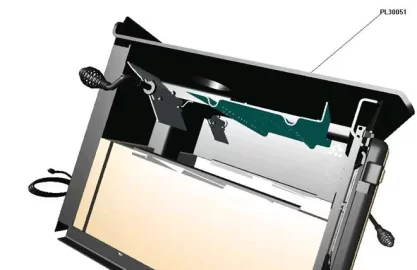

As I mentioned in a PM, the bypass is nice. Why a bypass? I presume it has to do with the exaust opening size. Once your chimney is warm (with the bypass open) close it the bypass, keep the door open for 10 mins and get the stove warm/hot. Close door, turn down the primary air and voila, you're set for hours.

It is one integral unit. If you ever need to replace the baffle, the secondary air tubes go as well. All in one.
Like I posted above, the quote was from a company rep who is often on this forum (not sure why he has not posted here yet...). I am certainly pleased with the stove. I always find it comes down to 4 things (warning: I am not a pro like most people on this forum): what size house are you trying to heat, how much insulation do you have, how drafty is the house and get at least 2 years ahead on your wood pile...dry wood is key to this stove (or any non CAT EPA stove for that matter).

Sorry guys, getting in late in the conversation. The 2300 is one of the few Osburn stove who doesn't use the C cast. If I stated as much in the past I apologize. Due to its design it is not possible to use this material. The baffle is thick stainless steel. See diagram below.
Also, the 2300 is a 3.1 cu ft firebox while the 2400 is 3.2. Regency literature states F2400 at 2.3 and the F3100 at 2.9.
Frybug ! Thank you...just could not picture it properly.
