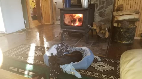

The wiener dogs knows not to touch

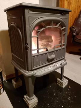

This is in Norway from when my daughter visited. They stayed in out of the way bnb's, and every one had a stove. Actually, the gov. recomends a stove as backup because most of their heat comes from electric (hydro) and if power went out at -40f, it could be a national emergency. I asked if there was any training or precautions - not that she was told.
