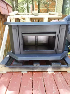

Yesterday we pulled out the old zero clearence wood burner. My new pacific energy summit insert is now waiting to be installed. Just have to weld up brackets to keep the old chimney up and then insert the 25' 6" flex liner kit into the existing10" stainless chimney. Also if any tips on using the existing outside air intake on the left side of the box let me know. It does talk about it on page 18 of my manual but if you have experience let me know.

Wait! You can not install an insert in that space. Read the manual. An insert must go into a masonry fireplace or an approved ZC fireplace. It can not be installed as a standalone in the space where the old ZC was removed. A PE FP30 might fit in that area depending on its dimensions, but not the Summit insert. A new ZC FP will also need new chimney pipe.
From the manual:
Your Insert is designed to be installed into a masonry or factory built zero-clearance wood burning fireplace. The masonry fireplace and chimney must be good working condition and built according to the requirements of the Standard of Chimneys, Fireplaces, Vents and Solid Fuel Burning appliances, N.F.P.A. 211 (Latest Edition) or applicable National, Provincial, State or local codes. The installation shall conform to CAN/CSA-B365, Installation Code for Solid-Fuel-Burning Appliances and Equipment. The factory built zero-clearance fireplace and its chimney must be listed per UL 127 or ULC S610 standards.
Warning: Under no circumstances is this heater to be installed in a makeshift or "temporary" manner. :ZZZ

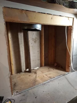

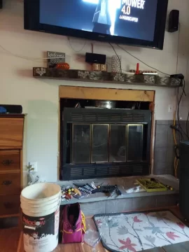

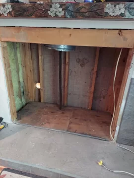

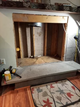

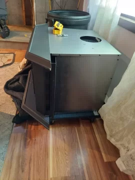

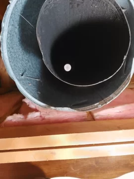

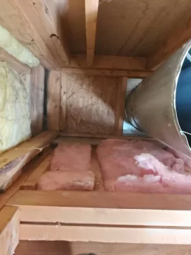

Can you post a picture of the entire wall there? Is the fireplace chase on an interior or exterior wall?
Yes, interior wall shot of the old FP location so that we can see what options may be available.
If you need others let me know. I have the space covered right now
Thanks, that helps. As noted earlier, the two options for replacement are a) a new ZC fireplace which can be much more efficient, or b) opening up the area to create an alcove for a qualifying freestanding stove.
Option a) may require lowering the hearth for some ZC fireplaces
Option b) would eliminate the TV location.
