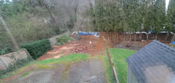

would you say that cedar (red and yellow) split in fall 2015 would be ready for winter 2016/17? south facing stacks. stays very dry all things considered. not a lot of wind though. i'll keep my eyes open for some DF. a friend of mine will be hooking me up with some alder this weekend!
see attached for current stacking.

Yes, it'll be ready. I would be careful burning loads of cedar. It takes off really fast.

That looks like a shaded and sheltered location. Hopefully our dry summer will accelerate drying but I would remove the top cover as soon as the rains stop and check it in July to be sure it is getting dry. I had some big leaf maple that never dried even after a couple years due to the stacking method and location. Watch for water puddling on the tarps and seeping into the piles at low spots. That's what did my maple in. With the tarp on top those areas never dried out.
