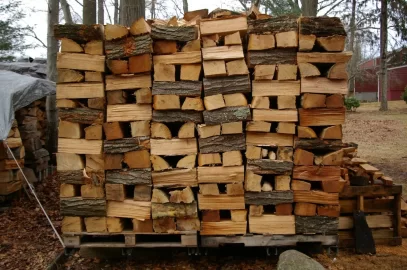

The absolute best thing that I have found for setting up pallets is the vertical posts from pallet racks laid out horizontally as stringers. I came across a bunch of pallet rack veritcals that had the diagonal bracing cut out a while ago. Why they were cut apart I have no clue, but when they were offered I took some and I kick myself in the butt for not taking the rest. The ones I got are 14' long which amounts to 4 pallets laid on the 40" side with a little space between them. The benefits extend beyond pallets lasting. They make for a perfect and stable deck when used with 6x6s and 4x4s and other scrap to level them out. (I only support the metal at three points, center and within 18" of each end.) You can put a pallet crushing load of wood on top without hurting the metal. I originally used them as stringers for stacks, 2 per row. I wizened up after a little while and realized that I could get get 2x the wood on top if I used pallets. Although I have no empirical proof, I think the extended airspace under helps with drying. It certainly does not hurt.
You can sort of see the metal under the high cube which was nearly 6 cords.
