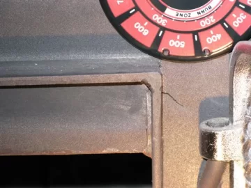

Need to take a photography class, but these give the general idea
these two are of the outside , to the left and right of the door near the top
  • [Hearth.com] PE Pacific Insert Not Bullet-Proof
first one is the the door jam on the right side ( the crack is in near the corner), second one is inside the fire box, basically stick your head in , turn your head to the left and look in the corner
have to click on the door jam pic to see the close up to actually see the crack

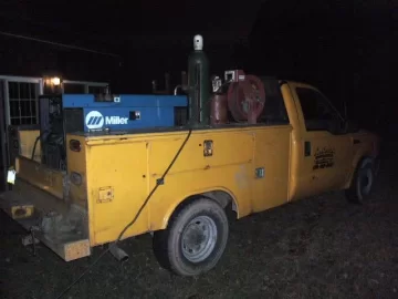

And finally a pic of the truck I got. The job took 2-1/2 to 3 hours.
And then I had to return the truck.

Frost, the welder actually did do that buffing with a "tiger pad" I think he called it. It was like a mirror finish almost, and he explained the reason for exactly what you just described.
I bought a can of paint today, painted the entire front, both side grilles, the ash lip, the top plate that overhangs, the lower front pc the slide leer passes through, the lever and the latch tab, of yeah and the entire 3 pc shroud.
Was only going to do the front of the firebox, but the other pcs has minor scratches, but would stand out next to the new paint on the front of the firebox, so I painted it all up front.
I pulled the EBT box out and found the flapper was not seated in place correctly at all, so was not working at all. Might have been letting air in all the time also. Called Cory at PE and he instructed me the way it should be set and advised no adjustments or winding needed on the arm. I need a shower guys, long day, I'm dead tires and got the insert up and running about an hour ago.
I'll post photos & such when I return.
Oh yeah, mine was purchased 2006 and it was manufactured 2006.
Yup, Tiger pad or horizontal flap wheel is what it is. Good.
Glad to hear its back doing what its supposed to be doing. Look forward to the pics.
Ok, I should have let the pain air cure a couple days, if it becomes a problem, I'll sand & refinish. I just had to see how it is operating .
I wanted to see if it operated better now that the EBT flapper was in position and covering the hole when it should be. I did not run it hot enough to engage the EBT yet.
Seems more level and more easily controllable. I won't really know till its up to full temp.
Here are some photos:
Right face after paint, and close up.
EBT, notice the bees, flys & ladybugs. Note to self, during yearly cleaning, pull EBT, inspect & clean.
Sorry, forgot to take a phot of the flapper in correct position. it has a tab on each side that sits in a slot in those brackets each side.
