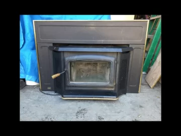

Hello,
I am considering closing up my open fireplace and installing a insert. This would be used on only the coldest days of the year or for ambiance. So I've been keeping my eyes open locally for any goodused options.
There is this PE super listed locally that comes with 12ft of liner for $400. Only the one picture in their ad. And I've requested a couple more. But I'm thinking I could clean this sucker up quite nicely for the price if it turns out to be in good shape.
I'm looking for any advice on things to look for besides obvious signs of overfiring. Also curious what sort of changes have occurred with this model over the years.

Well it's for real atleast, the seller has contacted me. So I may go look at this tonight or tomorrow if the interior pics look decent.
Am I overthinking it? Seems like a no brainer. For 4 bills Canadian. A little rough looking around the edges but not to bad. A little paint and elbow grease could bring it back almost new looking I bet?
I am very curious how/if this stove has changed throughout the years and if this is an older unit how that may affect my decision. I'm supposed to be getting a pic of the data label on it too.
That is a steal of a deal. The construction is essentially a smaller 2 cu ft version of your Summit, but with a coupled secondary air control instead of the EBT. There haven't been many changes. Look for baffle warping, general signs of overfiring, but from the pic it looks very promising.

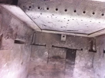

Here's the interior pics and the date of manufacture. A bit older but the baffle and supports look really good to me in the photo. Baffle pin is missing obviously but that's common.
I never try to get to excited about classifieds, until it's loaded and paid for.
[Hearth.com] PE Super Insert. Opinions/Info? [Hearth.com] PE Super Insert. Opinions/Info?
Looks like a 2001 model? Hope it looks good in person. My guess is the blower motor may need replacing or at least a good cleaning and oiling. Good luck.

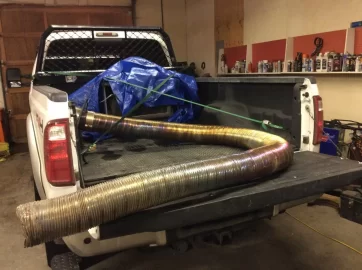

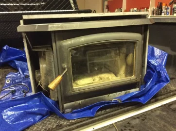

And it's in the back of my truck about to be pulled into my shop! Original owner, still had the manual. He tore his old house down and was building a new one, said he'd keep it and use it still except he didn't want/need a masonry fireplace so he was installing a PE zero clearance. Nice guy. Everything seems very good condition. I'll probably re-brick it for certain. Surround and all the screws/nuts and bolts are there. The liner is quite discoloured but top plate and cap included too. I'll get some pics in a bit.
Grabbed the liner/top plate/cap. But I dunno about reinstalling a 15 year old liner. Too short for what I have possibly already anyways.
Pretty filthy but I'm tearing it right down and cleaning it all.

Congrats, you scored well. With some cleanup and new bricks it should give you many years of warm pleasure.

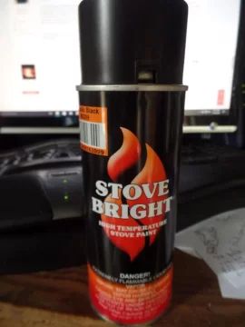

Can anyone confirm what the style of paint it is that PE uses on their base steel stoves like this one and my summit? Also does anyone have any tips for painting the bit of brass/gold trim that I have on this unit?
Any tips/thoughts are much appreciated. I'm kind of up in the air over the gold colouring but my wife really wants it all black, so you know how that's going to go.
I've been kicking around different install ideas but really need to measure the height of the existing flue. I could almost install with what I've got on hand and then buy a three foot piece to extend the top of my chimney to make 15'. That's if it's only 12' right now and this old liner would fit? Just kind of spitballing. The cheapness in me almost wants to go that route and try to keep this under $500 for the stove and the install. I don't plan to burn this unit more than part time as the summit in the basement will always be my go to 24/7 heater. Also my basement is finished and my daughters room is down there so the basement always needs to be heated. Just thinking this liner,used as it is may last me a lifetime? And I can easily inspect it myself, video it even periodically if I'm curious.
I thought it was Stove Bright metallic black , but could be wrong. Check with thechimneysweep to be sure. Sand the gold trim with fine 400 grit sandpaper to give it some tooth before paint.
Reactions: Squisher

Thanks Begreen. I thought that's what it was too. Metallic. I will look on thechinneysweep site too.
So I've stripped it right down, sanded and cleaned everything and have got two coats onto the back/offside of all parts
That Stovebright metallic black is a little tough to work with. I'll re-iterate what I had researched about it to shake it up very well.

Yep, Stove Bright Black Metallic,
Go with 2 light coats rather than heavy coats.

And I've got to sort my install. My masonry liners are 6x13 interior dimension. So time to research liners, I measured and the used liner that came with it is about two and a half feet to short even if I was tempted to use it. And I was tempted to be honest. Lol.
So here's my dilemma. Do I bust out tiles and try to get a insulated six inch down there? Or try to get away with 5.5" on about 14'-14.5' of interior masonry chimney? Either way I plan to stuff the smoke chamber with roxul and use a block off plate. As well as stuff the top of the chimney with roxul and seal the top plate.

Why not use the liner with a coupler and another short section of liner?
Reactions: Squisher
I was thinking of adding a few feet to that liner but it's 6" so isn't going to fit down without some coaxing. And at presumably 15 years old with some obvious hotspots over the years I was thinking of just getting a new 15' 5.5" liner.
Then atleast I would know the liner is new. I'm not to worried about it and would use it if I could. But I can get a new 15' piece of pipe for pretty reasonable.
