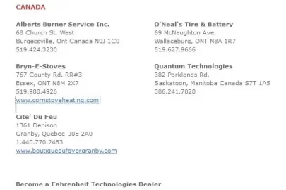

The eco-65 could go about 3 days max, and you would still have to do the burn pot cleaning. I would say your into a pellet furnace with a remote hopper. This is one sweet puppy at 50k btu..
https://www.hearth.com/talk/threads...d-some-leaks-in-type-l-exhaust-venting.61092/
http://fahrenheittech.com/index.html
This unit is self cleaning and has a 250 hopper extension. I wonder how much they cost, but it looks pretty too.. 6 bags about a 1 bag a day you should be good to go..
[Hearth.com] Pellet stove for just using cottage on weekends in harsh winters?
