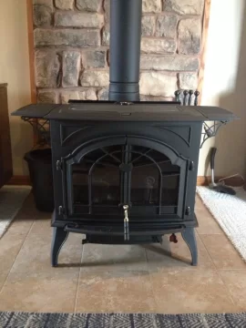

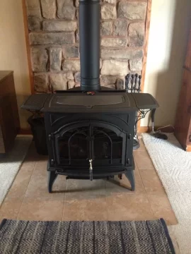

Got the shelves on today! Looks like a different stove now. Plus it has the mitten rods for warming things up! I used them all the time on the old resolute so it is nice to have them back. [Hearth.com] Quadrafire Isle Royale installed!! [Hearth.com] Quadrafire Isle Royale installed!!
