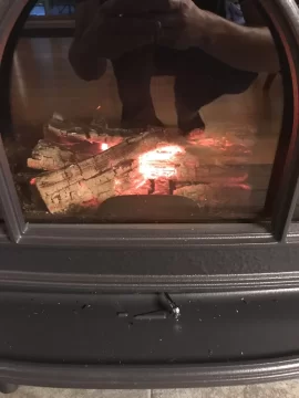

Hi All,
I am the owner of a new Jotul F500. I have been doing my break in burns at 200, 300 and now 400 degrees. I have noticed that when my wood starts to burn down all the flames go away and it the logs just glow red and you can see the air blowing on them. Is this normal to have logs not on fire when they are still a pretty good size? Is this going to clog up my chimney due to smoldering. I have tried opening the air all the way and you can visibly see the air pick up but no flames. [Hearth.com] Question from a new burner
Also I had a little trouble getting it up to 400 I may have not had enough wood as I was nervous of getting it too hot
Jotul F500, 27 foot interior chimney with 6” insulated liner. Currently about 68 degrees out.
Looks like a small fire approaching the coaling stage. At this point most of the volatiles in the wood have burned off. What remains is charcoal. Still some heat there for a while longer, even though no flames.
Reactions: Zoso2385

Yes, when the burn progresses, the wood holds its structure but the flames subside. However, the wood still holds a lot of heat value. Let it burn through its cycle.
Flames aren’t always indicative of a clean burning fire. This load appears to be pretty well burnt down and nearing the coaling stage. Go outside and make sure your seeing clear flue gases about 10-15 minutes after a reload of the stove.
Different wood burns differently. In my experience, ash burns with a lot of flame. Cherry burns with flame that is light and blueish, oak is a very soft flame but hot. Pine and basswood are hot woods that burn quickly and brightly.
Just make sure you are burning clean by checking you gasses coming out of the liner. You will get the hang of it.
Something to notice is the clean glass. If there is buildup starting with this type of stove, you would notice it on the glass at first as a cloudy dark haze, then black creosote deposits. Even after a short small burn. Your glass seems crystal clear. It would give an indication of what the rest of the system is looking like. Gray ash on the glass, fine. Dark creosote film, something needs adjusting.

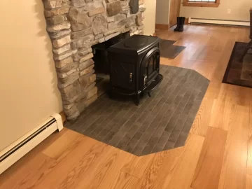

Very helpful input, thanks. I’m still a little worried about excessive draft with 27ft of insulated chimney. My installer said it’s possible but to try it out first before putting a damper in. Another thing to not is that I am using the rear outlet and on have maybe 14” of stainless pipe before it goes into a tee. Not sure if that would put the damper far enough away from the outlet.

Yeah, Zoso. Rear vent outlet set ups are not conducive to Damper installations anyway. Most manufacturers will explicitly state to only install the damper in a vertical section of pipe. With set ups such as yours, if restriction of the flue is necessary you might be best served doing it at the chimney cap.
I agree with the installer. Try it out and see how it works.

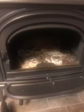

This intake on the bottom of the stove, does the bottom heat shield cover it up? Is it still easily accessible with the shield installed? I haven’t had a chance to look at my stove too much yet.
You can still access it with the heat shield in place.
