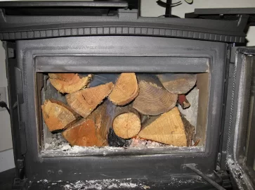

What will really cook your noodle is. What wood do you put on the bottom, middle, and top?
Do you put the largest pieces on top or the bottom? Maybe just the middle?
What species wood should you load and where?
That's overthinking it. Fill it with what fits. This is a hot reload in the T6 which has the same firebox as the OP.
