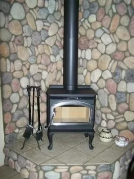

I'm not sure if the manufacturers have that info. I have manufactured stone behind my stove. I check it to make sure it's not getting too hot and it always feels nice and warm.
Here's a picture:
Here's a picture:
Very nice. What brand and model name is that stone?

It's a Country S160 Striker by Country Stoves.
