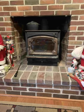

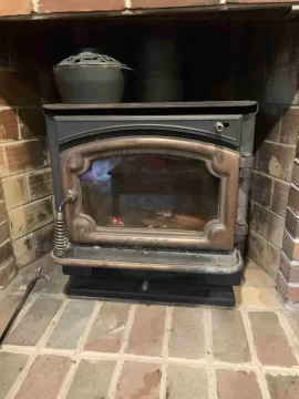

Condition wise, Its got some light rusting on the 'roof', but the firebricks are all good, the door glass is not scratched but the brass around the door is tarnished so i would want a new door probably, and a new trim piece, also needs sanding and a paint job (I had painted the top about 10 years ago for similar rusting or paint bubbling reasons) i have attached a couple pics.

A stove with no structural issues, and just cosmetic after 30 years needs a reprieve. That stove is a classic, It's great looking. If the ring is solid brass I think it can be buffed out.
