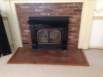

Hi all! First time post, although I've been visiting the site for years; hoping I can get a sanity check on a wood stove insert that I'm considering from Craigslist.
I have an 1800 square foot Cape-style home, 2 stories, in central MA. We have a relatively new (2 years old) HE gas boiler for our primary heat, and 2 fireplaces (not pass-through) in the center of the house. I grew up burning wood in a freestanding stove, and have wanted to put an insert into the smaller of the two fireplaces here since we bought the house; my goal is both to have a secondary heat source and keep the gas bills low.
I'm considering a Vermont Casting 0044 unit being sold on Craigslist. It appears to be in very good condition; the seller is an hour and a half away from me, and is asking $850 for it. It comes with the surround and blower.
Is this (a) a reasonable-ish price for this insert, and (b) worth buying? I realize it's an older stove, but I do like the look. Cost is a consideration, as I'll still need to spend another $2800-$3200 (based on quotes from the spring) to put an insulated liner in the chimney.

First time poster, long time lurker here too! I saw this stove posted a couple days ago. The price is pretty good. You'll find a lot of people who don't like the later VC products, but for the short money, I think it would be just fine. Honestly- if I hadn't already ordered a new cheaper unit (vogelzang colonial), I'd be very temped to grab this one.

It's a complex older fireplace insert, but a decent heater if all is in order. Still, for $850 I would consider getting something newer. For $500, in excellent condition it might be worth a try. Read up on some old threads to learn more about the insert, parts, etc.. If you go to look at it check carefully for cracks, especially around the grate area. Try the blowers, they often are a weak link and should be cleaned and oiled if still working before putting another season on it.

My problem with that insert would be the exhaust, it is the old rectangle style and you would need a converter to get it to go to 6" round.
