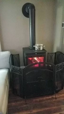

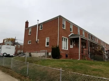

Looking good. Is this an apartment building?
I appreciate the will to heat with wood. But it looks tight to me. You mentioned being short of clearance on the top and ignored my question about the back wall in this thread. You also mentioned being shy on side clearance to the chase in another thread. I'm not trying to hound you but it's one thing to make the decision to cut those corners for yourself, but you have attached residences there too.
I hate to rain on your parade but some simple things like shielding or double wall pipe and moving the chase or cushions slightly could bring you into compliance.
Btw. I too think the stove looks great. Looks like a nice big firebox and should be a capable heater.

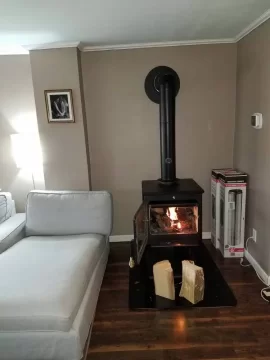

I am also curious. I don't see any shielding or double wall pipe in the picture.
Tripple wall class a through the wall. 20 inches from the rear to the single wall. Only spot tight on clearance is the ceiling to the 8-10 inches of horizontal single wall. Plenty of space otherwise.
The rear of the unit is 10 inches from the wall ( min 7.5 according to the manual and the rear is literally touchable under a load ). This is a low clearance unit.
Sent from my SM-G935T using Tapatalk

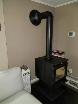

Did you shield the 8-10" of single wall or did you adapt some double wall?

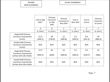

I'm curious of this clearance listing from the Madison/smartstove manual. They list single wall connector pipe as 12" from combustibles it appears to me?
Also they list it as 12"s to the collar at 7.5"s to the rear of the unit. Which only would equal 14.5"s at 10"s to the rear of the unit?
Am I reading this wrong? How can they list single wall connecting pipe as 12"s to combustible?

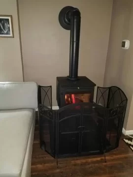

Couch is warm to the touch but I sat there all evening ( granted it was pretty warm there.... but I like it warm lol ). The Madison has good clearance specs all the way around. I didn't run double wall for the horizontal run. The single wall isn't creating a lot of heat on the ceiling likely because It's such a short run. Besides, Canada says single wall is good to 14" of clearance [emoji14]
I'm cruising at 400 stove top temp. It's about 80-85 on My first floor and 70 -75 on my 2nd floor. Still better than the gas furnace!

My guess is if Wayne measured his as 20.5"s from the wall to the closest part of the single wall that the manual is wrong then and that 12 should be a 18?
Reactions: WayneN
That would be Correct. The only part I was concerned with was the horizontal run but I could easily fix it with a shield or a double wall run.
