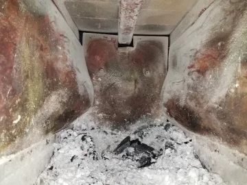

Here are 3 pictures of the fire box.
4. Months. Old. !!!!!!!!!
Hey HY-C...if y'all readin this...this is what not controlling chimney draft does for ya! Buy a stinkin clue guys!
Oh, and you guys owe this fellah a new furnace...:mad:
I am not a fan of the SS panels as mine are also warped, just not that bad.
Wonder if the panels were installed without the ceramic backing as they look folded in.
Willing to bet that the panels warped, allowing heat behind the panel and that is what cracked the firebox.
Hands down, they should replace that unit.

If you remove the screws for the top panel and the 3 on each side of the front panel. That will allow you to lift the top up slightly and pull the front panel off. With the panel removed, look inside and see if you have further damage.
