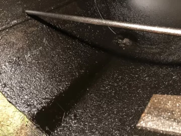

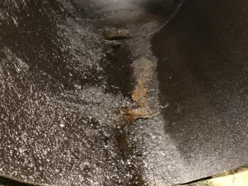

So how bad did I F myself here?
sardo_67
Sep 19, 2017
207
mid CT
got 2 500gal “propane” tanks, were used for fuel storage, full of sludge and years of fuel storage.
There anyway way to easily clean this or just scrap it and move on?

Looks like you already cut the ends out, you’ll have to clean them up to determine the condition, possibly a little pitting under the sludge, but that can be fixed.
I won't actually recommend this, and too late to help you. I filled my 1000 gal tank with water, added a very low suds detergent, fired the boiler and heated/circulated the water for several hours up to 190F, then drained the tank hot water, rinsed the tank, and used the tank thereafter with a hot water filter installed. Changed the filter multiple times over a one year period, and by the end of about a year the filter no longer was catching anything and not being discolored. That was about 10 years ago, and never have experienced a known problem. I don't actually know how much crud/sludge was in the tank, and I'm thinking that anything non-soluble and heavier than water just sank to the bottom and settled in the tank, no longer a source of any harm.

What is the thickness of the steel in your tanks? From your photos it is difficult to see but appears to me that it is not 3/8" like a 500 gallon propane tank should be. Are you sure they are propane tanks and not fuel oil tanks?
Is that a stay? I didn't think LP tanks had stays inside. Don't remember seeing any when I peeked in mine. Ya looks a little thin too.
they are 3/8 or so, tag says they are pressure vessel tanks for propane, this one is from 69 actually.
i read you can have them steam cleaned or something but it's not worth is since the HAZMAT issue this would cause for a real business is too much.
going to try and sell one then just scrap the other. soon as i hear they had fuel in them at one point i should have ran.

Just clean them.
Some soap and a pressure washer and a little time and you are good to go.
Add a filter to your system, and relax and enjoy the heat.
