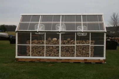

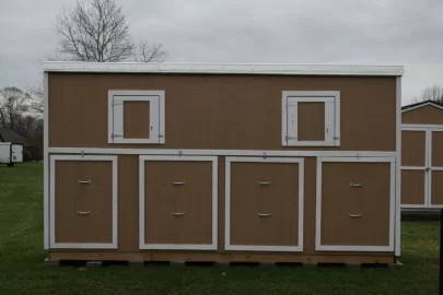

So here is my kiln.
The dimensions are 15 ft long. 42 inches deep, short wall is 63 inches tall, long wall 102 inches. The whole kiln, except for the trim, is constructed of pressure treated lumber.
The base is 2x6 construction with vapor barrier and r13 insulation under 1/2 inch plywood, walls are 2x4 with r13 covered inside with tar paper.
The panels are clear Tuftex polycarbonate panels that I bought at Lowes.
The small white boards at the base of the side tuftex panels are removable, so I vent the kiln by removing the boards and opening the upper doors on the opposite side.
[Hearth.com] Solar kiln.... [Hearth.com] Solar kiln....
The kiln roughly holds 1/2 cord. Inside are three cheap box fans that I run with a small generator.
With the Tuftex panels, I see internal temps about 25 to 30F higher than the ambient temp on a sunny day.
So far I have dried 1/2 cord of white oak, with the second 1/2 cord of the same in the kiln right now.
The first cord went in at about 30% water came out at 15% about 5 months later.
I tried the kiln without the fans for the first three months, but the drying was not consistent throughout the stack, so I added the fans, which made drying much more even.

So here is my kiln.
View attachment 217141 View attachment 217142
