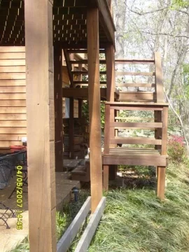

Here's some more photos showing potential hill movement. Note the vertical of the big 8 x 8 posts compared to the smaller 6 x 6 posts on the stairs. The 8 x 8's look like they are moving down the hill, to me.

Here's a look at the patio slabs. The smaller gap runs away from (perpendicular to) the house. The larger gap is parallel to the house. They were both the same when I moved in. I think the slabs are also moving ever so slowly down the hill. When I first noticed the gap widening I thought it was due to heaving, but I've changed my mind due to the slow and progressive widening of the gap.
The third photo is a side shot of the second photo to show the tipping of the slab as the gap has widened.
The last shot is the "inboard" side of the deck where it attaches to the house. The builder used joist hangers here (at least that's what I'm calling them these days).

Mo,
What Andre means (if we're talking about your deck problem) is this: if the earth is moving locally under the pier, it will shove the concrete peirs outward and take the vertical support posts "out of vertical"...this means the bottom of the post moves out, for example, 0.2 inches while the top stays pretty much as it was. When this happens, the post is no longer vertical but is tilted, in this case with the top of the post pointing (maybe imperceptibly) towards the house....to see if this is happening, get a "corner level" for about $6 at the store. It has a 90 deg edge to it so that you can put it on the corner of a beam..... It has two levels...one on each side. Put it on several posts (mark the place you put it on each beam using a pencil so you can return to that same spot later) and, using the level, "benchmark" how much each is leaning by observing how much each bubble has moved away from being level.....may be hard to do as I don't know how to measure each bubble other than to say "1/3 of a bubble lean to the left"...etc.....since you didn't do this before, don't get warped out of shape if it's not level.....it may have been level from day 1 but benchmark it now as a reference point and check it each week........over time you can tell if it's moving out of perpendicular....if the top of the post points more and more towards the house, the earth under the pier is probably moving down the hill ....if the top of the post points further and further towards the bottom of the hill, it probably means the top of the deck attached to the house is pulling away from the house relative to the pier or the earth under the house (but not the pier) is moving.....not likely as with that massive a movement, the pier will also move. There are other combinations of movement but the two mentioned would seem to be the most likely......
