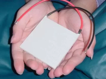

As for the TEG I am thinking this (broken link removed to http://www.ebay.com/itm/THERMOELECTRIC-POWER-GENERATION-TEG-MODULE-198-COUPLE-62MM-HIGH-TEMP-200-DEG-C-/281172863101?pt=US_CPU_Fans_Heatsinks&hash=item417735687d) on ebay should work.
[Hearth.com] TEG Powered Wireless Temp. Monitor
Model HT1-198-62
  • 62mm x 62mm x 4.0mm
  • Maximum Hot Side Temperature (Tmax) 200 Deg C
  • Lead Wire Length 330mm (13-inch) With Stress Relief Sleeves
  • Minimum Figure of Merit (Z) 0.0027
  • Parallel Lapped Tolerance +/- 0.05mm
  • Electrical Resistance 0.6 Ohm
  • Imax (Peltier Effect) 25.0 Amps
  • Vmax (Peltier Effect) 24.7 VDC
  • Qmax (Peltier Effect) 400 W
  • DTmax (Peltier Effect) 69 Deg C
  • Each device is fully inspected and tested prior to shipment
  • Perimeter sealed with EPOXY for moisture protection
Something like this for the transmitter that could be tucked around back of the stove would be nice. K type thermocouple. 3 inputs would be nice. Hook up the TEG to the battery to keep it charged?

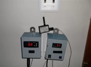

I have something similar, mine is made by Omega. I don't see a need for a TEG as the lithium battery lasts for years. It has only 1 input ( also has an internal sensor for ambient temp), I use it to monitor stove top temp.

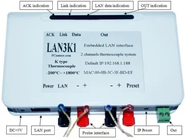

Check this out WES, just did find this, good price but it comes from China. (broken link removed to http://www.pcsensor.com/index.php?_a=product&product_id=66)
Says it includes both the master and slave for that price.
My question would be if it would work with a K type thermocouple.

I have emailed them to see if they have a wireless version of this in the works, if they do that would work, if not I might just buy this and deal with the cat5 cable running beside the blower power line. I could also use one of the 5volt POE adapters I have for my IP cameras sitting around.
(broken link removed to http://www.pcsensor.com/index.php?_a=product&product_id=114)
(broken image removed)
I have the Omega OM-CP-RFTC 400A transmitter and OM-CP-RFC 101A reciever..
The first wireless model looks like it only good to 125::C.
The LAN model looks like it would work fine.

The Auberins wireless unit works well I added one to my rig a couple of weeks ago. I can monitor what the stove is doing from my (home) office.

So the PC sensor has the ability to allow you to monitor over a network ONLY? and not use a wireless slave like the auberins? And obviously the auberins is the opposite, no network work ability. Am I understanding this correctly?

I still have yet to find anything affordable that I can hook into the network and read remotely, Omega has some stuff but it is really high priced.
