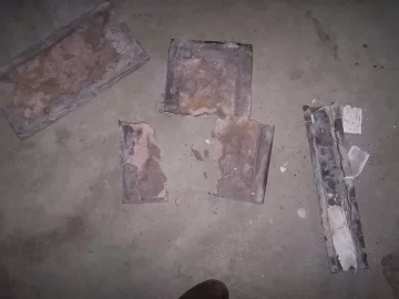

OK, I disassembled the insert today and have a sweep coming this Tuesday. Last year when the sweep came I just pulled the baffles, this time I pulled everything.
A link to the baffles online (broken link removed to http://www.stove-parts.net/Baffle_Kit_for_Napoleon_1400_1401_p/w018-0078.htm)
A picture of my current baffles, this insert has about 10 cord through it.
The metal bracket on the right covers the air tube for the secondary burn. The white material inside this bracket has not been identified as it is not on the parts list for this insert that I can find, any help will be appreciated.

if the white stuff was in that channel when you took it out, it is probably a mineral wool insulation that will likely come with that metal rail part when you order it
