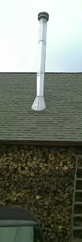

Because of the VC, I have the 8" cannon ready for the King. However, I'm not convinced that it will make that much of a difference over 6".

S an' W, where's the storm collar on the top of the roof flashing?
That is a good question. I have the guy wires to put up in the next few weeks; I'll have to take a look. It may have been missed when the flashing/extension was done for the new trussed roof last winter.
You'll definitely want it on there. Give it a good silicone bead where it contacts the pipe. I prefer rigid braces for vent pipe. I was going to ask about them next. Did it go all last winter without them?
There was a pretty good blizzard going when the chimney was extended, so the wires were not done. I don't think 24 hours went by after the shingles were finished that there was a foot of snow on the roof. The chimney is on the sheltered side of the house in a courtyard, so it is pretty well protected from the wind.

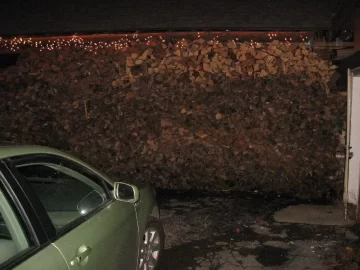

Her dad passed away shortly after that last post last August, so the house rebuild got put on hold for a while. As for the front porch, I think it found a permanent better purpose as a woodshed. There is 70 feet of porch, half of it covered, on the other side of the house with a much better view. Curb appeal only matters if you intend to sell right?
  • [Hearth.com] Time will tell if its better
