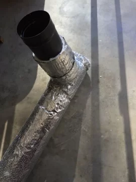

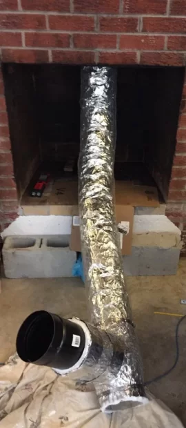

I have already decided I will insulate the liner. I am going to use a T and I guess I must abandon my desire for the hinged rain cap. If I comprehended the directions correctly, it is recommended the T of the Olympia Heavy Flex liner "Armor Flex" should be secured and supported within the chimney (or upper firebox in my case). The insulation, if I comprehended this correctly, should not be any closer than 6 inches from the top plate. So, I guess both the Armor Flex liner AND the insulation expand due to temperature rise and, I guess that is why it is recommended to secure the T and allow the top rain cap, storm collar, and clamp to float above the top plate.
What do you all think?
EDIT: You all are the greatest! Thanks.
No it is hung by the top plate in the chimney
Yes it will expand but if you stretch the liner out when you install it it will just collapse on itself and not lift at the top.
Why give up on the hinged cap? Do they not make it in your size?
I guess that works if the T IS supported by masonry or secured in the fire chamb
Because the liner has to expand in length upward. If it does this I am afraid the cap will block the flex liner and choke my vent.
It works just fine. If the tee moves to much I typically just use bricks under it. But the blockoff plate usually holds it in place well enough. I have never attached a tee to anything and never had an issue. And every liner manufacturer has you hang the liner from the top plate.
It will not even rigid liners wont expand that much but a heavy flex absolutely will not if installed correctly.
I insulated and finished the install. I am not sure if I will install/use a decorative plate over the fireplace opening. I
should have cleaned the brickwork but that can be accomplished next season.
