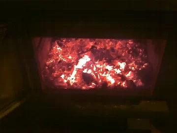

I do 12 hour burn cycles this time of year and usually reload on something that looks like this. While I fill it all the way up every time, I do vary what I fill it with depending on heat demand. For example, last night was some of the good stuff, 18" long, straight denser wood while this morning was chunks and uglies.

With a coal bed like that, and my t'stat set at 3.5, I still get plenty of heat from the stove to maintain the house temp. So, I typically burn my coals down much further than that.

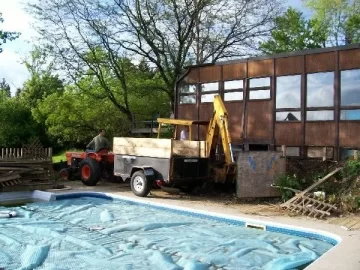

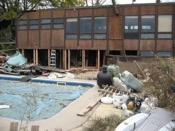

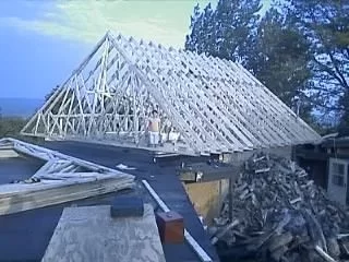

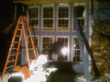

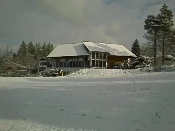

This is my third gut/rebuild and I'm not sure I have another one in me. I excavated on the downhill side of the house to solve drainage/severe water issues, put the trusses up to so solve all the issues with a flat roof in Syracuse and to get summer shading/winter sun through the south and SSW walls. Main level is 2300 sq ft, lower level is 1200. I'm currently just heating the main level but the lower level seems to stay above 50. Here is where I've been and today's update. Was cold enough today to freeze an IPA but the sun was nice.

Thanks so much for the photos. I love seeing you putting those trusses on the flat roof, and turning that modern box into something beautiful. Big props. Hang in there, you'll feel great when you're done. (I say that to myself every day.) [/quote]
