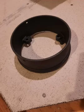

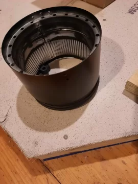

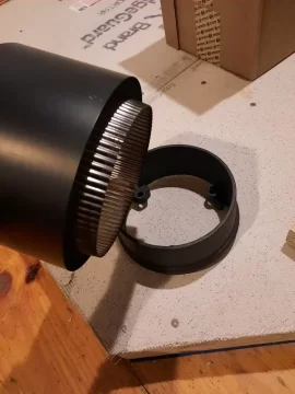

Hi everyone.
I'm using a US stove and the flue collar is supposed to be 6 inches so I got a dvk 6 inch stove pipe adapter to start my double wall stove pipe. The adapter slots into the flue collar so loosely that I measured it and the collar is actually about 6 1/8inch inner diameter. Am I missing something? How are you supposed to start the stove pipe?

Yeah, that's what I was hoping but it slides all the way down and wiggles around on my US stove
The DVL without the adapter is loose too? If so, the inner liner end will need a wrap of flat gasket. You might be able to use stove glass gasket that has an adhesive backing for an easy install.

Don't use the adapter. Return it.
Attach the DVL pipe directly to the flue collar without the adapter.

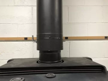

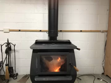

I had the same problem, different stove but the duravent dvl didnt fit snug, my solution was fairly easy once I got the right piece, go to your local store and buy a double male (both sides crimped) that should slide snuggly into the stove's collar, screw the (3) screws to hold secure, make sure the adapter crimped ends are flush with the bottom of the stove collar ( I trimmed mine) then take the dvl adapter and slide that crimped end into the top of the male crimped end, makes for a very snug fit, if you have a drill 1/4" extension bit you can zip in a few self taping sheet metal screws to make everything secure.

Technically, that changes the rear clearance unless there is a shield for that section. Single wall stovepipe require 18" clearance.
Wait for the DVL pipe to arrive. It may fit the flue collar nicely.

Dvl stove pipe arrived and fit snug on the collar.
Thank you for your help
Thank you for the update. I need to call DuraVent about this. Their DVL adapter fits few stoves properly.
