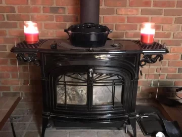

It is the 2040 model.Do you know if this is the 2550 or the 2040 model? Both have refractory packages that can get fragile at this age, but the cat model 2550 seemed to stand up better.
My guess is the market value is around $1000 before the options. It's one of the best looking classic stoves on the market, but I would not offer anything for it. The repair record is too high and costly and they can be fussy to operate. There are better options.It is the 2040 model.

The 2040 is the latest Encore model with the updated refractory. The refractory in the 2040 It is not fragile at all, but a hardened rock like material. Begreen has his models crossed, the 2550 that is the older Encore model with the softer refractory material that was prone to failure.
I'm on my 3rd year with my 2040 and have had no issues whatsoever, this stove replaced a 2550 that I ran for 7 years.
I paid $2600 for mine so I would think a used model would be worth somewhere in the range of $1200-1500.
But it is still much more complicated with many more parts to break. Yes they are allot better now but honestly allot better than complete crap isnt nessecarily that great compared to most other stoves on the market. There are other stoves on the market that look every bit as good and are much less complicated.The 2040 is the latest Encore model with the updated refractory. The refractory in the 2040 It is not fragile at all, but a hardened rock like material. Begreen has his models crossed, the 2550 is the older Encore model with the softer refractory material that was prone to failure.

I had a 2010 2N1 Encore (2040). My brother currently has a 2011 model. The gaskets that hold these stoves together eventually fail, and consequently, the stove needs a full rebuild, which would cost you more than its worth. The decorative panel across the back is easy to break with the top load feature if one is not careful putting wood in the stove. They're very difficult to control with the tstat- one must use the amount of wood to control it (or insert in a greener piece with dry wood) to even get 6-8 hour burns. They're also cast iron (not jacketed) so the room they are in tends to be 80 degrees or more. The wall around them gets very hot with min clearances. My brother is very envious of my BK (except the smoke smell woes). I will never own another Encore.I am looking at purchasing a used Encore from a private party with following add-ons: side racks, factory blower kit, and cast iron stove top humidifier. It is a 2010 model appears to be in great shape. What is a reasonable offer for this stove?
I have not had any of these issues with mine, but I'm only on my third season. When did yours start failing?I had a 2010 2N1 Encore (2040). My brother currently has a 2011 model. The gaskets that hold these stoves together eventually fail, and consequently, the stove needs a full rebuild, which would cost you more than its worth. The decorative panel across the back is easy to break with the top load feature if one is not careful putting wood in the stove. They're very difficult to control with the tstat- one must use the amount of wood to control it (or insert in a greener piece with dry wood) to even get 6-8 hour burns. They're also cast iron (not jacketed) so the room they are in tends to be 80 degrees or more. The wall around them gets very hot with min clearances. My brother is very envious of my BK (except the smoke smell woes). I will never own another Encore.
