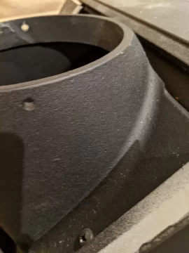

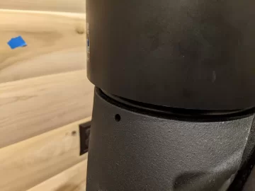

Ugh. So I finally got my parts and I'm starting to think the store that sold me this was right. They are having a hard time getting a hold of vc for answers.
My DVL pipe inner wall fits inside the stove collar and the outside wall of the DVL goes on the outside of stove collar....but due to a really odd shape of the stove collar the DVL only inserts 1/4 of an inch. That's not going to work. The screw holes on the stove collar would require a pipe that somehow wraps around this weird stove collar that also flares out as you go down. See pics
Any suggestions?

What is stopping the DVL from inserting deeper? Is the flue collar tapered so that it increases in diameter?

The stove collar gets wider as you go down .
It looked that way in the picture. Is the outside edge of the DVL binding on the flue collar or is the inner liner bottoming out on the flue collar attachment brackets? If it is on the inner brackets, the crimped inner pipe of the DVL could be notched 1/2" to clear the brackets. If the outer jacket of the DVL is binding then a short extension may need to be spliced onto the inner liner of the DVL.
The inner liner of the stove pipe fits snug but not too firm. It's because the outside of the stoves collar flares wider as it goes down into the stove. And then there is that weird but out that is merged with the stove so that would be the absolute limit of how far the stove could recess down into the stove collar on the outside of the collar. There is no limitation of the depth on the inside of the stove collar. There are no brackets of any sort just three hole where you would faster the stove pipe or stove adapter. I really have never seen anything like this before in any of the stoves I looked at recently at stores or friends.
I cannot imagine the expectation is to rig some sort of single wall pipe into or outside of a double wall pipe. First it would be extremely difficult I would imagine and second doesn't they defeat my clearances which I intentionally bought this stove for the 12 with double wall clearances. Or maybe I'm not understanding what needs to happen.

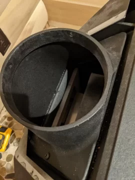

I realize I didnt REALLY answer your question very well.
The outside wall stove pipe cannot go further in the stove flue collar as it. widens the further down you go. So I can only get about 1/4 of an inch of stove pipe onto the stove collar, and would need a good bit more to fasten it with screws.
The inside sits snugly inside but very easy to move around. That seems to be a constant size from top until when the opening widens from the stove collar.

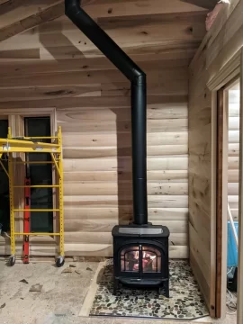

As Im sure someone will wonder into these forums with the same issue, I should provide an update here.
Thanks to begreen and other folks for responding.
In short: You WILL need a single wall stove adapter AND a double wall. At least, if you are using Duravent double wall stove pipe. The single wall adapter model number is
6DBK-AD​
and the double wall adapter model number is
6DVL-AD
IF you are just using single wall pipe, you wont need the double wall adapter as well.
If you are using double wall pipe:
First, the single wall stove adapter gets pushed as hard as you can inside the stove flue collar, then you use a rubber mallet to gently tap it to seat it further. You shouldnt see any of the flaring sticking up outside the stove, seated up to the seating 'rib'. It should be near impossible or really difficult to move this adapter out of the flue collar at this point. Next you place the double wall adapter on top of this. It doesnt seat snug, it just seats on top of. And then build your pipe up and out.
I didnt have screws long enough to tap through the double wall adapter into the single wall adapter. This actually helped me when I was aligning my pipe etc to the ceiling support. Everything seems to be seating equally and firmly, but I do want to screw the two together, hopefully that wont present a problem.
Im attaching a picture of what the stove looks like with both adapters installed on the stove. You can barely see the single wall adapter with the double wall on top of it.
I did a test fire, small one with a good bit of thicker kindling in log cabin format. Then I added a couple of logs. I left the room for an adult beverage, and returned in panic as the room was filled with smoke. When I started the fire I had smoke pouring into the room and then closed the doors. I guess a little looks like alot when you walk into a room.
Then I noticed smoke coming out from all over the stove. I thought I over heated it and cracked the seals, I thought it was defective, I thought I screwed up. Im still abit worried, but I'm pretty sure it was just smoke from manufacturing oils etc coming off the stove. It was late when I fired this up for the first time. I couldnt pass up the opportunity! I had just finished the install at around 11p ish, and as this is at our cabin, and we had to return home the next day, I knew I couldnt do a test fire the next day as we had to leave somewhat early. We have a fireplace as well and never burn on Sundays as we have to return home by Sunday evening. Wife woke up, freaked out because she smelled smoke and 'chemicals. She was right. It did smell pretty bad. Between the pipe and the stove, there was a bad smell all throughout. I had to take an air filtration system into the bedroom area to stave that off and open some windows. I then watched the fire for the next couple of hours, listening to 'my music' and drinking beers.
Hopefully I will get many opportunities to test/use this thing in the coming near future. I want to work out any issues I may have before it really gets cold. When I fired this up, it was pretty warm inside and outside. It felt warm to walk up to but I could still touch the stove pipe walls about 12" up briefly. The stove was too hot to touch 'iron hot'. and the wooden wall to the right was damn hot which I will need to monitor (im at minimum clearances +1"). The goal is to put a dinning area to the left of the stove, this is an addition I put on. SO I couldnt really move it left much more and bought this stove (and looked at others) because the clearance was what it was. I really didnt feel the room being warmer. BUT I also had to open a couple of windows because of the smell.
After adding the logs, it was kind of a bummer because I really didnt get to see the flames much anymore after awhile. It just burned slowly with an occasional flame showing up. I eventually got bored, tested the smoke detectors in that room and went to bed.

The stove pipe should be screwed to the flue collar. And each joint of the stove pipe gets secured with 3 screws 120º apart.
New, painted stoves smoke a lot as the paint is breaking in. We often advise people to break in their stoves outdoors if possible, or at least open the windows and put a fan in one to exhaust the fumes outdoors.
The manual recommends 3-4 break in fires but with little guidance. Generally, this is done with a small fire at first, then gradually larger fires. Something like 300º, 400º, 500º for the first 3 fires. Do you have a cat thermometer or stovetop thermometer for the stove? The stove paint will be fully baked-in after a few 500-600º stovetop temp fires.

If you are using Duravent DVL or Durablack, you will be fine as long as you got the right parts.
If the DVL, you will need both
6DBK-AD​
6DVL-AD
If you are just using durablack single wall stove pipe, all you will need is 6DBK-AD.
If you are using some other manufacturer, Im not sure what options you have available to you, however likely something similar in the corresponding lineup (single wall adapter gently pounded into the stove collar, then a double wall adapter that sits on top of that)
The end result should look like what I pictured above as the two are connected together onto the stove.
