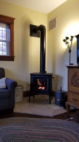

Go with the craftsbury! We got one a couple months ago and love it. The downstairs of our 2-story house is about 650 sq ft and it does a great job heating it. I don't have experience with other stoves, so from a complete novice, this one is great! It looks beautiful too.
