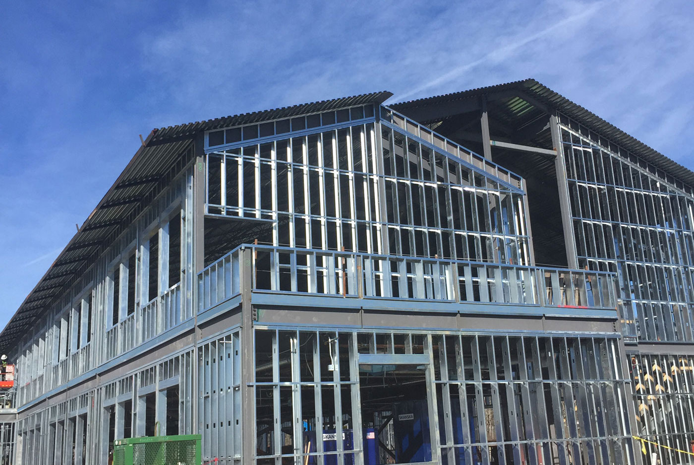

Bumping this since I really need to know. I would assume 20GA is an absolute minimum. I found this online but I think it is for exterior load bearing walls with standard brick rather than a partition wall with cement board and thin brick:
Brick Veneer Steel Stud Walls
