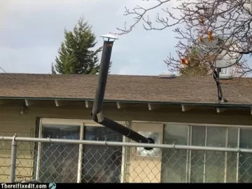

I have seen lots of single wall snap lock stove pipe run out though a wood panel stuck in a window and run up the side of the house. I honestly dont know how some people don't burn their houses down. I have seen lots of other horror story installs but the single wall ones are probably the most dangerous

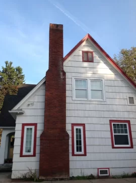

On my house (1932) it has a brick chimney without any liner The chimney is about 35" from base to top, it lays against the side of the house. It has a long bolt through the middle to hold it in place. I would suspect that the 18" x 36" shacked up bricks would have fell over by now if it was not bolted to the house. My Blaze King Princess insert used that chimney for a long time. I pulled it due to safety concerns and when I dropped the rigid liner inside the chimney it had to make a jog to clear the bolt that is in the way.
Sounds like the bolt might be a retrofitted bandaid for a sinking chimney foundation.
Not if it was built on a good foundation
Is the liner insulated?
The chimney has not settled (siding is original, easy to see) and the placement of the bolt looks original. I have seen this done on other Portland area homes.
I have seen it before to but as long as there is a good foundation there would be no reason for a chimney to fall over other that outside forces like earthquake ect. There are lots still standing allot older than yours.
No, I was told not to by the dealer. With a lot of the input I have seen here I realize that was likely bad advise. It is rigid, heavy walled stainless. It has a block off plate on the bottom. I get about a quart of creosote out of it twice a year. Much of the wood I have burned was minimally dry. I am currently ahead on the wood pile for the first time in a long time, I have very dry wood for this year and will have for at least the next two after that.
Yes definitely bad advice. You have no clearance to combustibles and not even any old liner to help protect the combustibles. If it was my house i would be pulling it and insulating it
You can see my hesitation of pulling it back out.
Not really that is not to bad at all. We deal with allot worse on a regular basis. but yeah not great access
