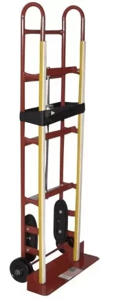

Getting them down the stairs is relatively easy. Lots of ways to do it. You can usually take 100+ lbs off the weight by removing the door and the firebricks (note how they went in first!).....
If you have two or more people, a good hand truck with the stair thingys on the back and a strap will do the job.
If you want to do it the slow way, some flat boards and stuff like that will allow you to slide it down (use thin sheet metal or even cardboard to let it slide easier and tie it back to the truck, etc.
In both cases, the friction will slow things down considerably and you will control it.
Typical hand truck pictured below...you can rent them...
[Hearth.com] What large stove?
