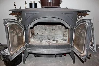

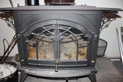

this is the stove shes gonna send better pics later i guess you cant really see from this pic but i thought id post it
  • [Hearth.com] what stove brand??
Warming shelves are also an option that ain't overly cheap. Nothing too glaringly wrong so far. Better (bigger) pics of the inside too please. Make sure the little porcelain handle that screws into the door latch is with it. My box only came with one that you were supposed to transfer from the top loader handle to the front door handle. Complete BS and my dealer gave me the second one. I am pretty sure they are available from Quad.

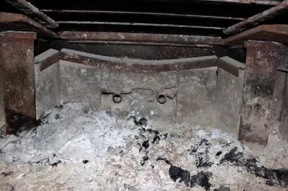

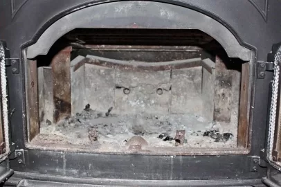

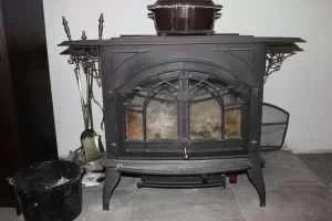

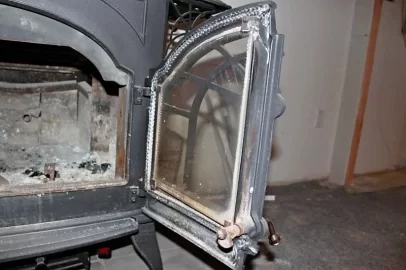

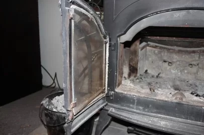

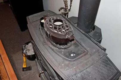

is it me or this stove looks beat up ???

They were not kind to that stove for sure. BUT - the good news is that with a paint job and fixing that angle iron in the back of the stove (thats the one I was telling you to look at), I think this stove still has a lot of life left in it. I couldn't really see the tubes in the top of the box. If there are no cracks in the cast - I think you still may be dealing with a pretty good deal.
I think a bunch of what you are seeing - is a dirty stove. I bet she cleans up pretty well.
i got her down to $1400 including all the chimney. new fire brick set is $160 and a new angle iron in the back is $38.00 I was thinkin it might be still worth it to but wanted more opinions?????
