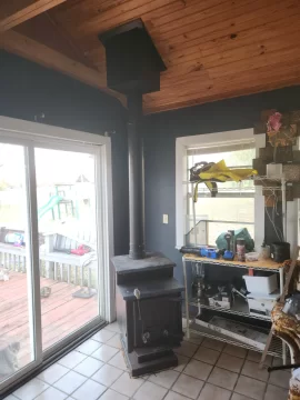

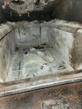

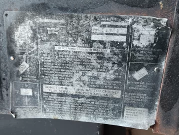

I think the aticker on the side says Model 24-FC / 24-AC but some of the letters aare faded. It has a blower attached to the back. I need to buy a catalytic combustor and impingement plate for the stove.

I can't read it either. I can definitely see 4 FC and AC but after that I'm not sure. My eyes aren't that great either. I did a search for Englander combustors and found this:
Not an endorsement just a a search result. They do list a 24-FC and a 24-ACD but looks like quite a few stoves use the same combustor.
I looked on the Englander website but I didn't see a manual for either.
Found manuals and parts here:
https://pellet-stove-parts-4less.com/pages/englander-wood-stove-owners-manuals-by-model
I would shop around. Remove your combustor and measure it. Yours is 6" round and 2" thick then it is the FC if it is 3" thick it is the AC model.
The combustor part # is the same for either version. Part #AC-6C3. - 6" round and 3" deep. Get it with the Interam gasket.
These stoves were a bit cleaner burning, but most of the heat from the cat went up the flue. There should be a flame impingement plate protecting the cat, Part # IP-24AC. Was this taken off for the picture or is it missing?
Reactions: Burnin Since 1991

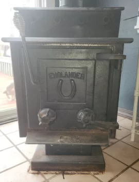

The plate and catalytic combustor are both missing. Ive never used the stove and just recently replaced the ceiling box, pipes and chimney. Now I'm going to replace the combslustor and plate. Seems the plate is not in stock so I will just make one from 1/4 inch steel plate.

According to the manual. this stove has a 30" clearance requirement. It can be reduced to 12" with proper NFPA 211 wall shielding.
I have shielding ordered and also a catalytic combustor. Ill get the real impingement plate ordered when it comes back in stock. I already have a new door gasket kit and some furnace cement to fill some gaps between fire bricks. Also id like to add, the stove is not being used at present and has not been used since I've lived here. Ive just been trying to get it back into working condition before I need it
