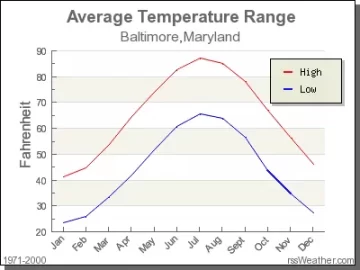

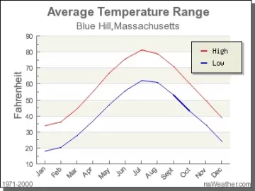

FWIW, this is in Maryland, not Massachussetts. On average, a steady 25-30K BTUS is going to make a good dent in the oil bill.
[Hearth.com] What to expect?
To be fair, a steady 30k btu will make a good dent in any heating bill. The $ savings is just a function of the cost of fuels. Once you decide to just partially heat with wood the stove selection process becomes much easier.
The stove will constantly be pooping money into your bank account every second that it is running instead of the oil burner.
Difference being that due to the mild climate, for maybe 4 months of their heating season the stove may be able to heat the whole place as compared to the same setup in a New England winter.

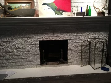

So I started looking at the Woodstock Ideal Steel and I'm really liking it. I actually find it attractive where I never was excited about the looks of the princess insert. Im concerned if it will fit since the hearth is raised and only 22" wide so some of the stove will project over the edge. I'd also need so form of heat shield for the mantle and a hearth extension on the floor.
I've been putting off buying the stove until my old house sells. We are supposed to settle next week so I'm trying to work out the final details before I take the plunge.

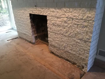

I'm still focused on getting a Woodstock Ideal Steel but I'm not sure what to do about the hearth. It's raised 12" and only 20" deep. The IS legs are 20" apart so a portion of the stove will hang over the hearth... are there any good resources on building out a raised hearth? I can't slide the stove into the fireplace because the fire brick is built up a few inches above the hearth top.
I imagine I'll rip the tile off the hearth top, build out a section of the hearth in front of the stove with block. And then top the whole thing with bluestone or something similar. Any better ideas out there?
Here's a crappy pic of the fireplace. The opening height is 33" from the hearth top and it is 34" wide.
What's preventing you from removing the firebrick?
Down with the masonry! Replace with a nice vertical pipe!

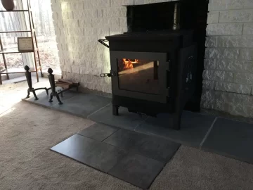

I installed the stove last Sunday and I've been running it since. So far so good I've been able to run the stove very low and heat the stove room to the low 70s. The kitchen is adjacent to the stove room with an 8' wide entry way and I'm not getting much heat in there. It's running about 10* cooler which is concerning given how mild it's been here but not totally surprising given how much glass there is. I ordered a floor fan so I'll try pushing cold air out of the kitchen.
The other furnace which heats the bedrooms has been running like usual so I'm obviously not getting heat back in that part of the house. Once it gets cold, well at least cold relative to Maryland, I think I'll have to run the stove pretty hard to keep up. All of the glass in this place just sucks the heat up! I think the next steep is looking at replacing the glass panels but that's going to be a slow process because financialy I can only do a few at a time. I might also look at the insulating window films but I think replacing the glass diy will be cheaper. I haven't yet found a diy insulating window film.
Take a basic 12" table fan and set it on the kitchen floor, pointed toward the stove room. Run the fan on low speed. In about 30 minutes you should get a notable temperature increase in the kitchen.

I've found Begreen's tip to work really well. The opening between my stove room and kitchen is fairly narrow. Putting a quiet fan on the floor blowing the cold air into the stove room works wonders. I can feel the hot air dumping into the kitchen thru the upper part of the opening. I run the kitchen ceiling fan on low and the whole side of the house evens out nicely.
I also run my furnace fan on recirc to help move heat around.
Let's see some stove picts/flame show videos...

I still have some work left on the hearth. I need to grout the tiles in front of the stove. Right now they're just on a piece of durock. I also want to seal the bluestone and fix the messy mortar joints the mason left.
