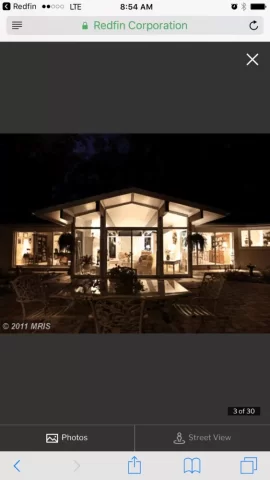

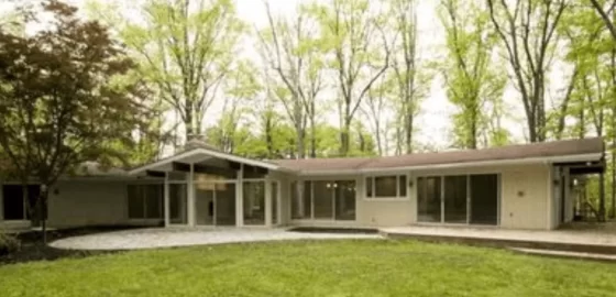

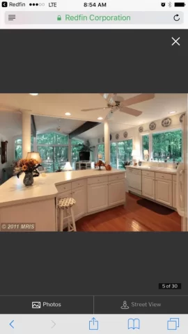

Here are a couple of pics from the real estate listing for some reference.

That's a lot of glass. Even before the stove, I'd be taking a hard look at the big patio doors and all the windows in the house. Make sure everything is double-pane and non-leaky.
[Hearth.com] What to expect?
Replacing leaky single pane glass isn't cheap, but it's cheaper than not replacing it, and you appear to have more stake in this game than most. :)
Ha, you found me! At least it is all double pane glass. I'm moving from a 900 sq ft cape cod to this so you can understand my concern. I've tried to ask the sellers what their typical bill was but haven't had much luck.
