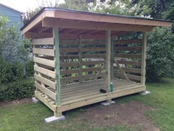

23% split a 4"x4" piece of oak out of this wood shed. Full air circulation all sides and bottom.
Thats a little high.. i dont even like burning wood that is 20% I shoot for 18%
That reading also may be off and the reading may be higher than 23% if the split was not checked at room temperature.
My wood sheds are also well vented your really looking at 18 to 24 months untill your ready to burn that wood
That's what I have to work with. I'm sure it would burn better being lower but 23% isn't all that bad. That's right out of my wood shed not room temperature. Heck, today's humidity is 53%.
Nice shed! At 23% it's a little bit on the damp side, but it'll burn. This is what I expected. For a hotter and quicker start, try making a couple 12" long "sleepers" to raise the wood a bit. A 12" long 2x4 split in half works great. The sleepers allow air to get under the splits for a quicker start. On a restart, rake the hot coals to the center front. Then place the sleepers N/S about 6" apart, alongside of the hot coals. Now load your splits E/W on top of the sleepers.
