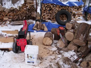

On sale and with a 20% off coupon $340.00, The Harbor Freight 7 ton has split every thing I put on it, including 20" rounds,except knotty elm
  • [Hearth.com] Who Said the Electric Splitter was a Waste?

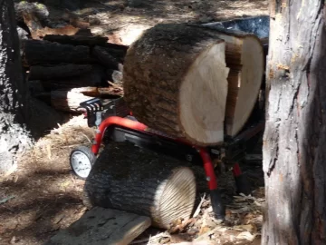

I've raved on about my Homelite for years. I'm sure everyone is tired of hearing it. It is my only splitter and I share it with a friend. We both use about 5 cords per year. Biggest I've split is 28 in. dia. black oak and 30 in. dia. Douglas fir. I'll buy another when this one quits.
