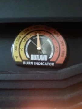

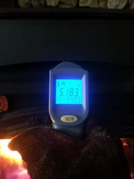

Just joking with you. So I've attached two pictures for reference to show how much temperature can vary using different devices.
My Rutland thermometer, which is similar to yours is reading slightly above 400f, but my IR pointing at the top is showing well over 500f. That over 100f difference. So the point is that fire doesn't burn evenly and it'll vary depending on where you measure. I wouldn't get all wrapped up on the stove temperature, but focus on getting it insulated and the rest will take care of itself.

I think your wood is not dry enough.....

Thanks for the feedback! I picked up my IR gun today and will use it along with the Condor magnetic thermometer to gauge temps. My guess is you are right that the Condor is probably reading 100 degrees or so lower than the actual firebox temp. I also plan on using the IR gun to check the temp on the flu collar to give me a better understanding of how hot it's burning. Either way...next step is the block off plate & Roxul insulation when I can get some time & help to do it. Even if it's not the whole solution, I want to make sure I've done everything to make sure I'm getting the maximum heat out of the insert. This has been one hell of a learning experience:)
Okay...I've been burning steadily since yesterday and have been checking temps with the new IR gun compared to the Condor magnetic thermometer. Essentially, the IR gun will read a little higher during start up/from a cold start (about 50 degrees higher). But once the insert finally gets up to cruising temps (about 450 to 500) the IR gun seems to read just about the same temps as the Condor? When I can keep the insert in the 450 to 500 range all is well...it's kicking out great heat with excellent secondaries coming off the baffles and my electric heat pump is NOT on. But...and this is a big but...I noticed when the temps starting getting into teens last night, I had a hard time getting the insert back up to cruising temps if I let the fire burn down to coaling phase. So essentially if I try and just let it go thru a 4/5 hour burn cycle (after loading the firebox up to the gills)...the firebox temps drop down too quickly and I am fighting to eventually get it back up to cruising temps. Again...just thinking I'm basically losing too much heat into the masonry and up the flu without the block plate and insulation...especially when it gets really frigid out. The most disappointing thing right now was having my heat pump kicking back on when the insert firebox temp would drop below 400 degrees. Again I have a very well insulated house, just under 2000Sq.ft & brand new high efficiency windows...and this insert is rated to heat this size home (the dealer certainly told me that)!
