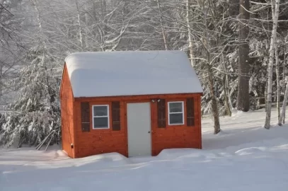

This is what I'm somewhat trying to match--I think what I'll do is use T&G for the front, so that I can stain it to look the same and keep snow out, and either 1x pine with spacing or lattice on the ends (can't see one side, other side only when approaching yard from front, and leave the back wide open--the back faces trees and no snow blows that way.
