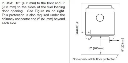

Front clearance is measured from the front leading edge of the stove. Its how much hearth you must have in front of the stove.
Are you certain? Normally it is measured from the stove glass.
BeGreen, I think you may be correct about measuring from the glass. I always erred on the conservative side, and when my inspector measured he used the absolute leading edge of the FV. If your stove has an ash lip, you would be penalized by it. I will speak w/ WS about this important detail, but it would be nice to see it in writing.

This always should be in the stove's documentation under the hearth requirements. Then there is no ambiguity. Be sure to ask Woodstock to supply written documentation if it is not in the Progress Hybrid manual.

It's the same for all stoves Ray. The PE manual could be more explicit, but at least they show a clear illustration.
