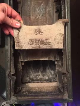

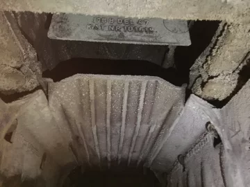

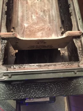

Here’s my stove

Thanks for posting. That's very helpful. It's been at least 15 yrs since I have had a chance to look at an earlier 118, but I didn't recall this being an issue. Doug8498 check to see if your flameout plate is hanging in the right location.
That is very interesting indeed thanks indeed for posting. That’s definitely not where mine was and mine looks to be larger than the part you posted. Perhaps you were right that mine was some sort of aftermarket part.
I can’t check right now as the fire is going, but at some point soon I’ll pop the top off and see if I have that slot you have where it can fit in.

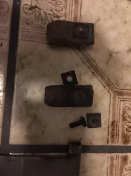

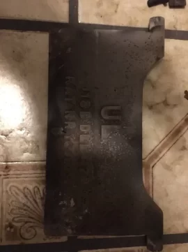

Ok so here are pics of the parts I pulled out. The flap is the same as yours Betty. My side with the letters was installed to face into the stove so you couldn’t see it on previous pictures. I popped the top off and I do have that slat that you showed, but that metal piece doesn’t really fit in there it just rests on top.
As you can also see I have other hardware that was used to fasten the metal flap into the stove opening. There are prefabed holes in the stove where some hardware is supposed to go. I do believe that the metal flap is supposed to go in the door opening.

If you zoom in on this last picture there is hole to the right of the stove opening where the hardware I have is meant to screw into.
hmmm. Im not sure what all that hardware is. As you can see, the little slats are cast into my stove and the piece just drops in there. What year was your stove made?
1979. The hardware is used to attach the flap to the pre drilled hole shown in the last picture. Like I said In my previous post, my neighbors all have this stove, and there’s are all installed the way I showed in the previous post (partially covering the firebox). On mine, If you look towards the back of the stove near the exhaust it has an Identical set of slats to the one where you have yours dropped into. I don’t think that is what those slats are meant for. If you get a chance check to see if you have those predrilled holes on the inside to the right and left of the door.

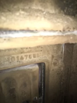

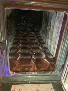

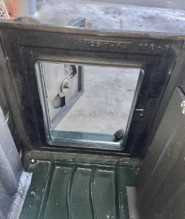

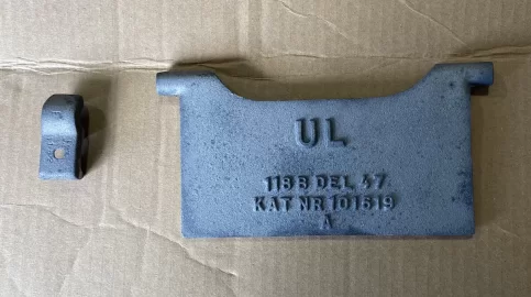

I ‘m new to the forum and I see that the posts were from more than two years ago but I have the same question regarding the placement of the flameout panel. As the photo of the inside front panel shows, there is no pre drilled hole to attach the plate. What to do? Did some of the 118 models not come with a flameout panel?
Correct, 118s were made in UL and non UL models, the non UL models had no flameout plate.
