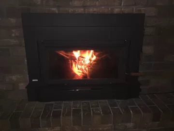

I've been able to run several fires in our new Sirocco 25 insert now. It definitely throws out some heat! I've been trying different log configurations trying to get a good overnight burn. Most of my fires have dwindled to small coals after about 7-8 hrs max. I have it loaded up tonight with some shorter splits running N/S. Here's the stove about an hour and a half into the burn, thermostat's been on low for a half hour and there is some great flames yet.
  • [Hearth.com] 2016-17 Blaze King Performance Thread (Everything BK)
That certainly doesn't look like a BK on low... 7-8 hours doesn't sound right either. Very interesting. I don't suppose your chimney is excessively tall?
My chimney is about 17 feet tall. It's an exterior chimney with an insulated liner. After another the flames have died down. A lot of the wood is down to coals too. I'm sure I'll be up letting th dogs out in the middle of ththe night so I can check on it after a few more hours.

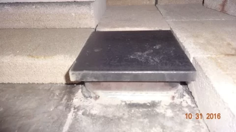

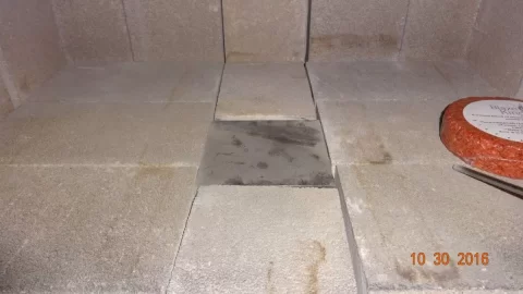

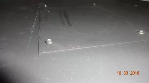

I don't mean to change the subject. I just have a quick question I hope someone can answer. I've decided I don't want to use ash dump in my sirocco 30. I'd rather just shovel out the ashes. Is it ok leave the original ash channel seal and plug in place? I don't want my shovel getting stuck on the loop of the other ash plug. See pics.
Wow... never seen a "loop-less" plug, like that. My stoves both came with just a single plug, and it has the lifting eye atop.
Weird. Mine came with the plug with the loop too. It's just not installed yet. I was wondering if I could just keep the bottom plate and flat plug on. The flat one doesn't move. It's somehow being held by the bottom plate on the stove.
another pic with the bricks removed:

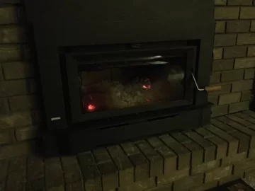

So with that same fire as before the cat needle is just falling out of the active zone, only a few small chunks of wood left. This picture is about 5 hours after starting the fire, could something be wrong with my thermostat? Is there a way to check it?
The wood I am burning is ash with moisture content around 18-20 %
