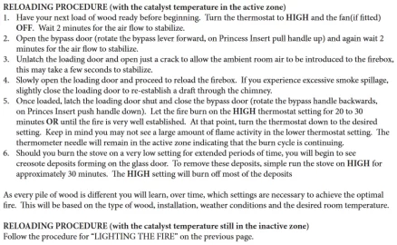

"RELOADING PROCEDURE (with the catalyst temperature still in the inactive zone) " ............... "
Once loaded, latch the loading door shut and close the bypass door
That's not what I'm seeing in your manual....that looks to me like the procedure for when the cat is in the "active" zone:

From my manual.
Those who've been here a little longer will remember BKVP contradicting the manual on this issue, and suggesting a few minutes in bypass on a hot reload. That's from where I got my procedure.
I'm firmly in that camp as well; Ya gotta burn a load in and get some wood gassing, or the cat has nothing to eat. My light-offs also seem to benefit from the higher temps in the top of the stove (around the cat) that a lively burn-in creates....YMMV with the steel stove.
View attachment 189711 View attachment 189712
Yes that is exactly what I have been talking about for the last couple of pages reloading when the stove is "RIPPING HOT" not the end of burn and trying to get a feel for shock to the cat when the door is opened and the protect of it that is required. If the stove is ripping hot it would mean it is most likely in the active zone. unfortunately I cut and pasted the bottom line from your page 1 not the top line, my bad, good catch.

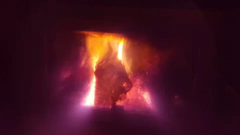

In related news.... The weatherman says it's finally time to clean my glass!
[Hearth.com] 2016-17 Blaze King Performance Thread (Everything BK)
About time!
