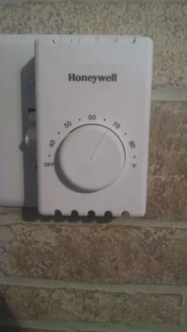

Isucet...I am very interested in your experiment controlling the fans with the wall stat....I will be expecting a fully detailed report soon! lol
If you want thermostatic control of the fan lots of options are available on Amazon. Just enter "line voltage thermostat".
Here is one option:
https://www.amazon.com/dp/B01ASYNO00/?tag=hearthamazon-20
The reason I am using a line voltage wall thermostat is cause i can keep it at normal high that is about 4 to 5 ft. reason to it is cause if i use an outlet thermostat the draft at floor level when fan is on can affect the performance of it. that is why when you installed a wall stat to control a furnace manufactures recommend that high for a better performance and more accurate reading of room temp. Maybe i am wrong. my problem now is to get a better one with better accuracy cause this one is 3-5 degrees accuracy i am trying to find one that is single pole and with better accuracy maybe in the +/- 0.5 of a degree or no more of 1 degree.

well, i will not get that technical with this and fried my brain, i use more my brain with my ham radios and antennas and a lot other things that i am into it. i just trying to have better control of that fan overnight cause after all these stoves handle that task with no problems. saying that, it is for sure the stove will still have wood in AM when i get out of bed. i just don't want to short the burn time with the fan on if is not necessary overnight. if i turn the fan on before go to bed and later the house temp can be keep just with the stove, why to use the fan all night and short the burn time? I just want to go to bed and let the thermostat decide if i am going to need the fan or not to bring temp back and keep back rooms into acceptable temp.
Plus i have something else to do and play with without get to technical about it. lol. just just
