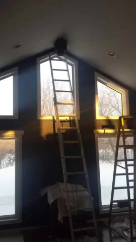

So close!!!
[Hearth.com] 2016-17 Blaze King Performance Thread (Everything BK)

Beautiful install you are going to enjoy very much for many years.

Gotrek. That looks fantastic. Congratulations.
